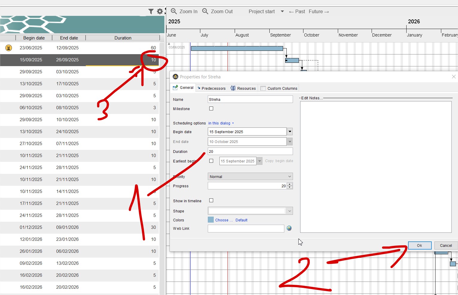

Hello, in the attachment log and print scren. One example, if i change duration (1), click OK (2) it does not change (3). Thank for the help.
ganttproject.log (20,5 KB)
Thanks for the log. It appears that Java Runtime can’t create a temporary file that it needs. Probably, the issue is with the permissions on your disk. Please check that you have write permissions in C:\Users\andra\AppData\Local\Temp\ folder.
I filed a new issue to the issue tracker to fix this problem in GanttProject code and continue operating even if it lacks some permissions. It will be available in the next major update, most likely.
