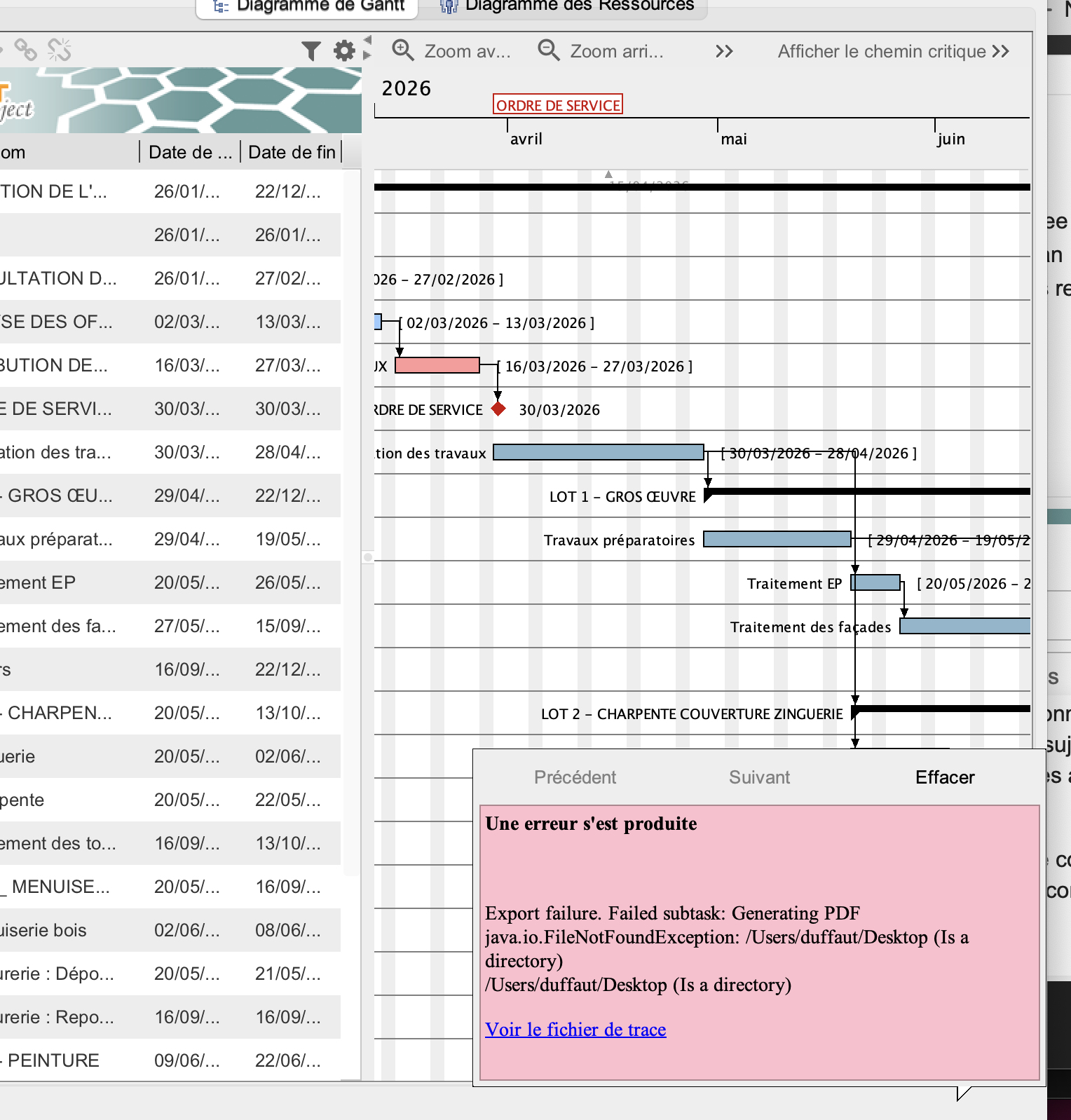

Export failure on macOS
Is a solution exist ? thanks

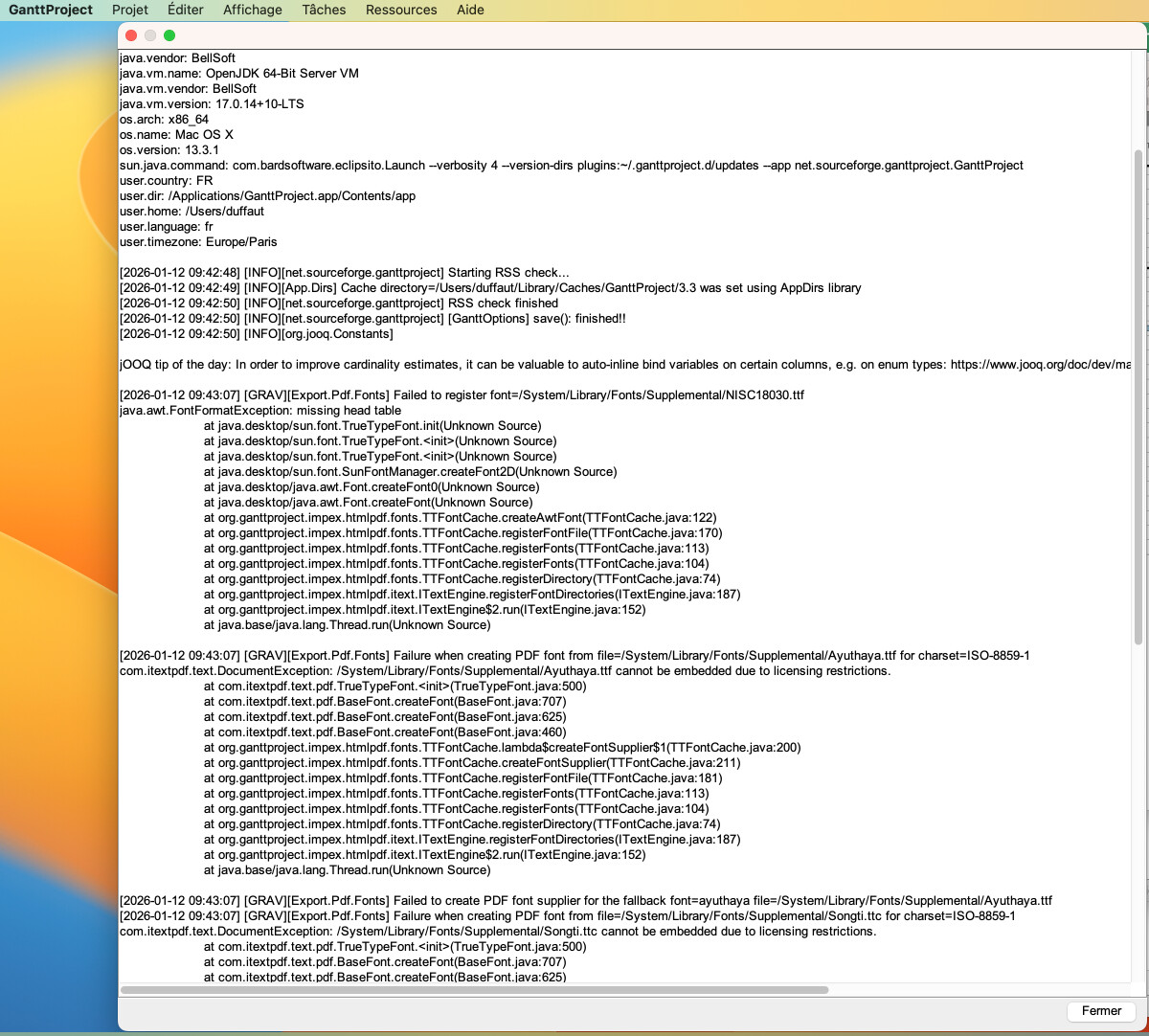

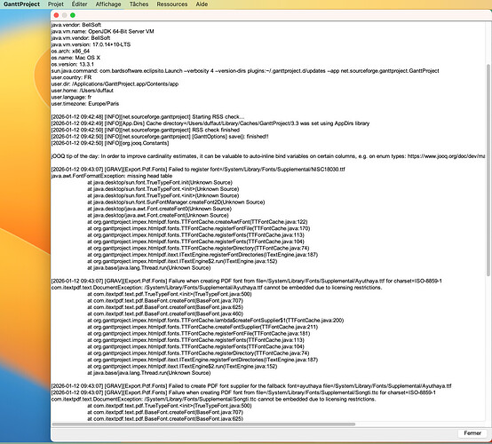

Hi, I add trace file to my initial demand, for all intents and purposes - thanks again

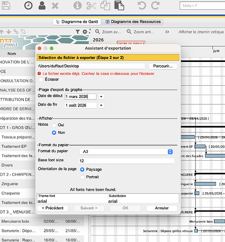

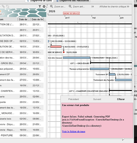

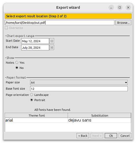

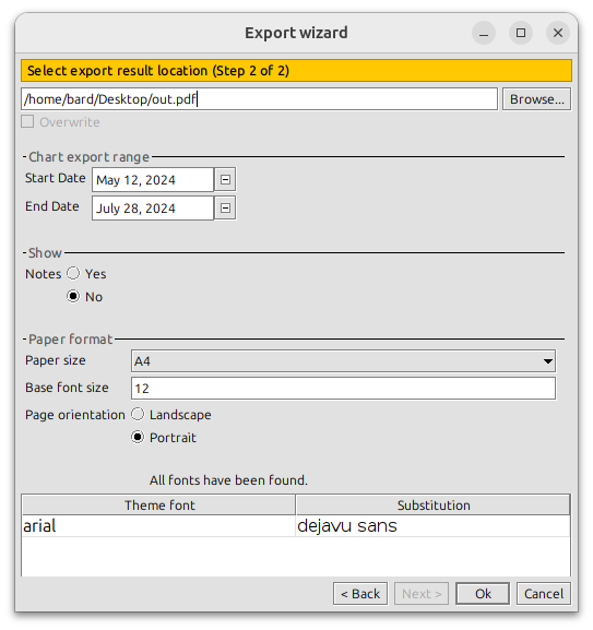

It says that you are trying to write a file instead of your Desktop folder. Please specify some file name inside the output folder, e.g. out.pdf
