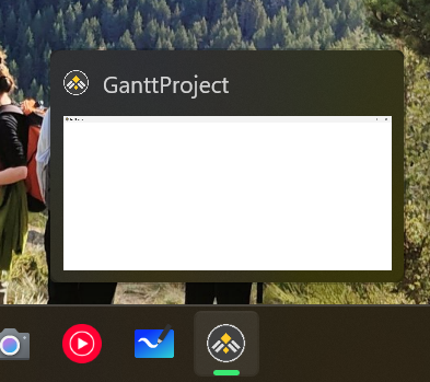

After installing Gantt Project on a computer with W11 and clicking on the desktop icon, the program does not open. The task appears as open, the icon appears on the taskbar but it simply does not open. Is there anything that can be done?

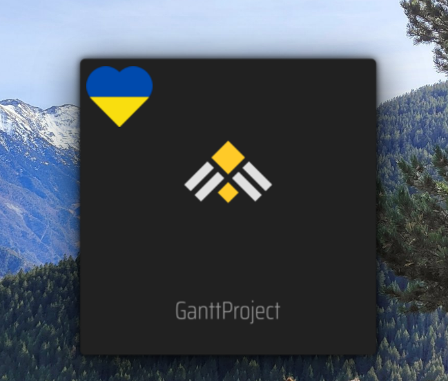

Hihi, I confirm that splash screen appears but then the GUI does not start. No error messages during install or when I try to open the app.

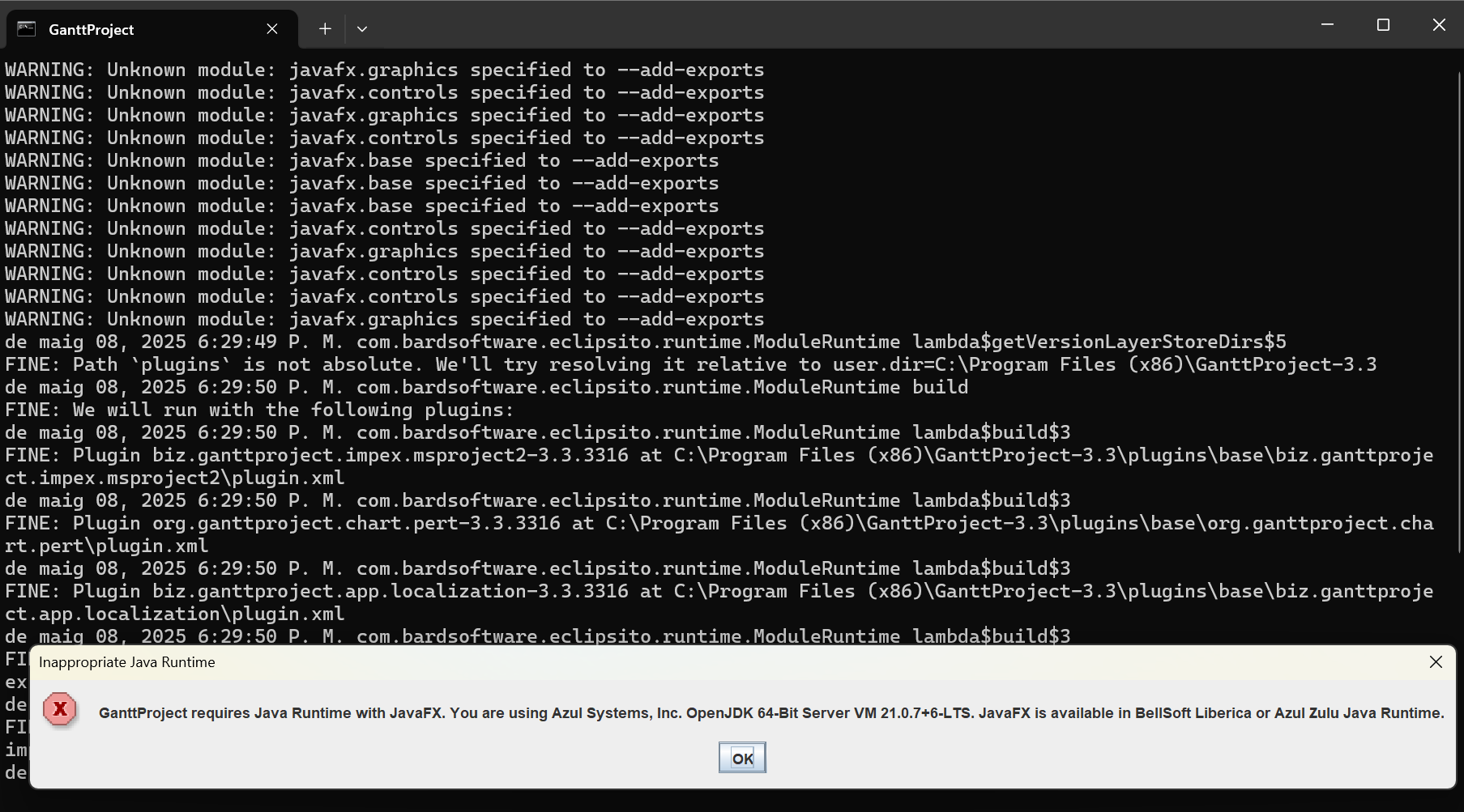

If I open C:\Program Files (x86)\GanttProject-3.3\ganttproject.bat I get the error on the attached screenshot.

GanttProject 3.3 requires Java 17 with Java FX modules. Both Azul and Liberica are okay, as soon as they are Java 17 and have Java FX. As we can see on the screen, you have Azul 21 and most likely without Java FX. Chances are that uninstalling it will solve the issue, because GanttProject comes bundled with the required Java Runtime, and will use it unless some other Java runtime is available.
