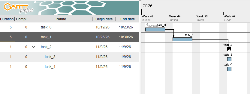

Hi, let’s suppose I have a project with a few linked tasks where one of the tasks is a parent task (not sure the right term here, sorry). If one of the predecessors of that parent task is pulled in, say duration changes from 10 days to 5 days, the parent task isn’t also pulled in. Why is that? Is that a setting somewhere I can change?
It is a bug. The recommended workaround is to create a dependency to one of the child tasks.
