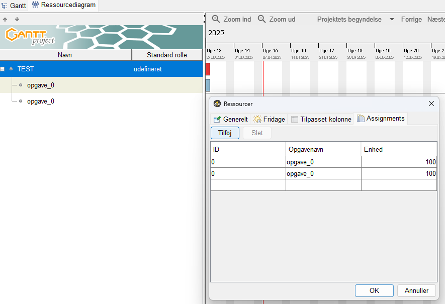

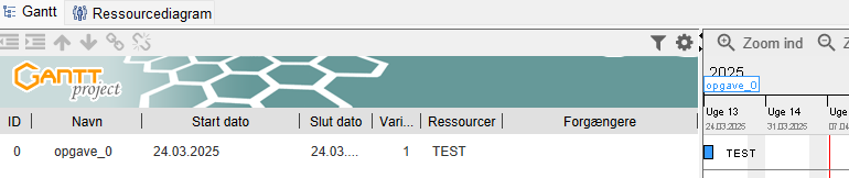

When I assign resources to a task, they appear twice in both the resource diagram and the resource assignments. This makes it seem like my resources are overloaded by 200%. If I remove one of the duplicate tasks, the resource is no longer shown on the task in the Gantt chart.
The pictures hopefully show my issue. Here, two different resources are working together on one task. I tried removing one resource in an attempt to clean up the assigned tasks, but the task remains. The other resource was only added once and has the same task listed twice in both the resource diagram and assignments (not shown).

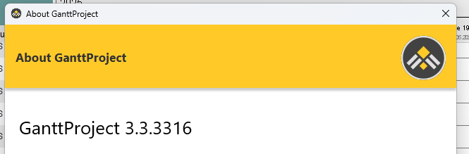

Are you sure that you’re using GanttProject 3.3.3316? Can you try uninstalling it, removing .ganttproject.d directory from your home folder (to clean any possible updates) and installing GP 3.3.3316 again?
That’s what the about section said.
I’ll reinstall and try again.
